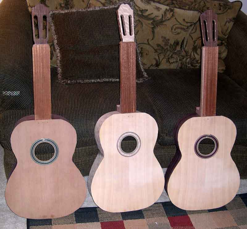

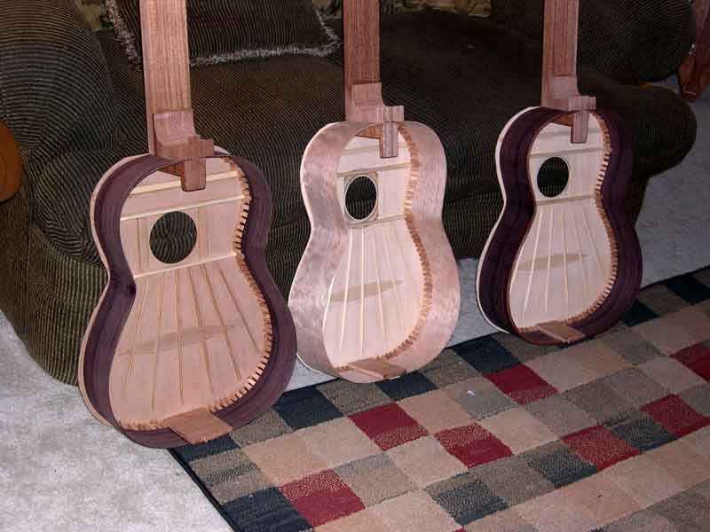

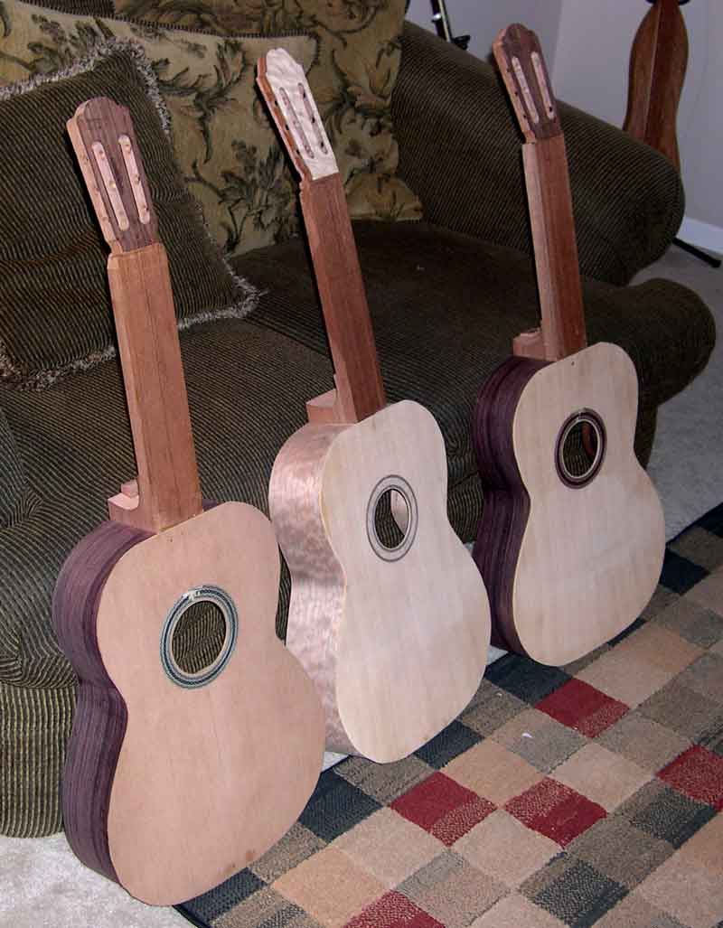

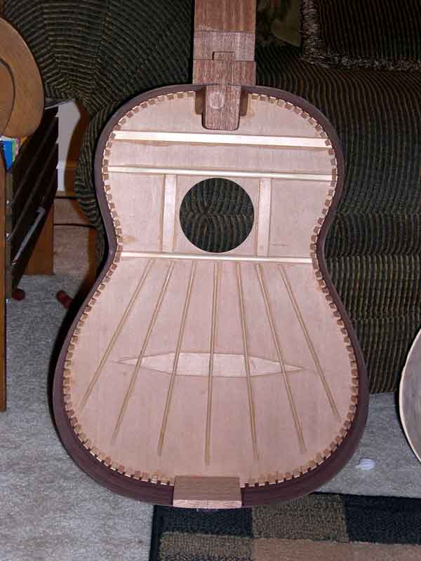

Well, staying true with the Hauser building style, I glued over 400 individual tentellones on today attaching the tops to the sides. I figured I'd post a few pics before I close up the boxes. I still have some cleanup work to do, but the big job is over. You'll notice one of the guitars already has a solid lining glued on the back. That should help make things go much quicker. Each of these guitars is the same basic plan, however I'm experimenting with a few things to see if it makes a difference in the finished guitar. Enjoy!

Woah! Such meticulous work! Good job, man!
PostPosted: Sun Jul 30, 2006 12:39 am
Looking good John. So are these going to be slide classicals? Those necks are looking awefully big...

Very impressive. I hope you didn't get tentellitus placing all those wedges! What different things are you trying?
PostPosted: Sun Jul 30, 2006 2:10 am
Posts: 731
John,
Beautiful work. What variables are you testing? I see the larger tail block on one of the 3, is that something you are testing? Also, is that maple back and sides on the middle one? Did you use hide glue?
Please keep posting pictures as you work on them.
Jeff

Yes, the tailblocks are slightly smaller on two of them. I'm trying to see how light I can go without compromising integrity. Also, you will notice the bottom two "V" fan braces are gone that are typical on a '37 Hauser. This is a modification made by Hauser III that I am trying for the frst time. All my previous Hausers had the lower V braces. Also, you can't see it but there are differences in top thickness--again trying to see how light I can build without compromising integrity. And finally, there are the obvious wood differences--cedar/rosewood, spruce/rosewood, and spruce/quilted maple. These are probably too many differences as the guitars will be quite different based on wood selection alone. But, my main reason is to see how light I can build the guitars without them falling apart. I've never built a guitar for commission so these will eventually hang on my wall and hopefully provide good data for future builds.

[QUOTE=Sprockett] one thing that I starting doing was carving my heel before I attached the sides, and I would cut my neck sides down to the shape. I found it just made doing the guitar easier and I didn't risk wrecking my sides :)
That's how I used to do it also. This time around I am trying it Robbie O'Brien's way from his dvd. I like the simple elegence of carving it after the fingerboard is on.   I've never been completely satisfied with the heel in the past, and I'm hoping doing it this way will improve my results. You are right though, I will be nervous carving around the heelblock.
As a side note--there are many steps in these three that I have done differently following Robbie's dvd. I really like some of the different options Robbie presents in building. He has some very simple, elegent ways to do things I've struggled with in the past. I think I will stick with a good bit of his techniques for future builds and incorporate them with some of the other methods I already have.
